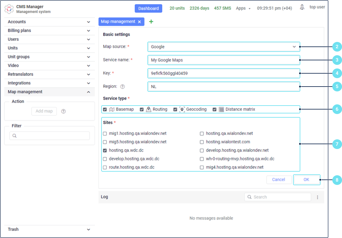

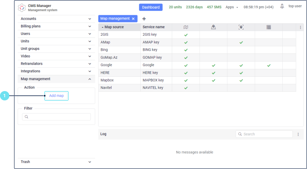

  1. Click on the Add map button in the Map management section in CMS Manager. If you have purchased the key from Gurtam, you don’t need to add the map. Find it in the list and click on it to open its properties.
  2. Select Google in the Map source field. In case of using a key from Gurtam, this field is filled in automatically.
  3. Give a name to the service you want to use for providing access to Google services. It will be shown on the Services tab of the billing plan and account properties.
  4. Specify the API key if you have purchased it yourself. In case of using a key from Gurtam, this field won’t be shown.
  5. For displaying the basemap correctly and determining addresses, specify the code of the region in which it should be used. For example, NL for the Netherlands (see all codes).
  6. Select one or more service types you need:
    • Basemap: allows displaying maps;
    • Geocoding: allows determining addresses by coordinates and coordinates by addresses;
    • Routing: allows planning routes;
    • Distance matrix: allows calculating the length and duration of routes and optimizing them.
      If you use your own key, you can work only with the services available for your key. In this case, the charging of units depends on the selected services and the number of requests.
      For a Gurtam key, all types are available, and you can’t cancel their selection.
  7. Select the sites where the Google service should be used. These can be your own sites or Hosting sites, such as hosting.online.stavtrack.kz, hosting.wialon.us.
You can’t enable or disable map access for the Logistics site. Therefore, if an account has all the required services enabled, the users of this account automatically get access to the maps when they log in to the Logistics application. In this case, a charge for using the maps starts to accrue.
  1. Save the changes.
After this action, Google services are not automatically available to all the users of the selected sites. They become available only after you enable the required services in the billing plan or account properties. You will begin to be charged for the services when the users of the account with the enabled services access the selected sites.

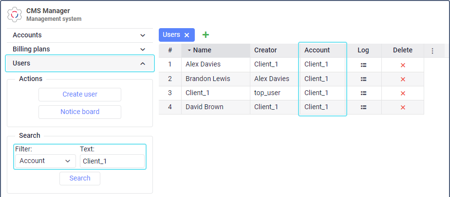

  • When you enable the services, Google services become available to all the users of the account. To check what users belong to the account, use the Account filter in the Users section, or sort the table by the column of the same name.
  • If the account has a user for whom you don’t want to enable Google services, you should delete this user or create an account on their behalf. After that, the user will belong to their own account. You won’t be able to do this if system objects have already been created on behalf of this user. In this case, you can copy the user in the monitoring system, selecting a user of another account as the creator, then create an account on behalf of the copied user, and delete the original user.

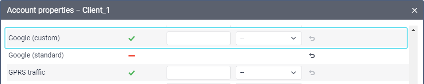

To grant access to Google services to the users of a separate account, activate the following services in the account properties:
  • Google (custom), if you have purchased the key yourself, or Google (standard), if you have purchased the key from Gurtam;

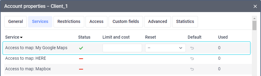

  • the service created in step 3 of the Creating and configuring the service section. Its name begins with Access to map: …

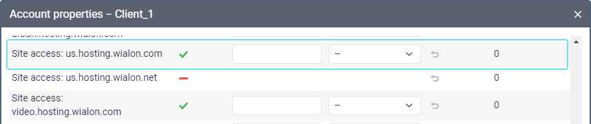

  • the service Site for the sites to which the account users should have access (see step 7 of the Creating and configuring the service section).
After that, Google services become available to all the users of this account. If the key is purchased from Gurtam, fees for their use start accruing after the user logs in to the monitoring system, and depend on the number of units available to the user. It does not matter whether the maps are selected in the user settings and in the menu on the map (see the section below). If the key is purchased from Google, fees are charged for each request sent to Google.

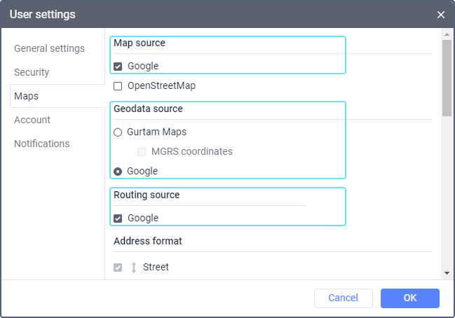

  1. On the Maps tab of the user settings, select Google as a source of maps, geodata or routing, depending on the service types specified in step 6 of the Creating and configuring a service section.
  2. Refresh the page.

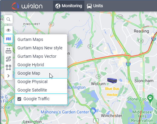

  3. If you have selected Google as a map source, enable the necessary basemap in the menu on the map. You can also enable additional layers, such as Google Traffic, if available.
After that, the user can use Google services.
