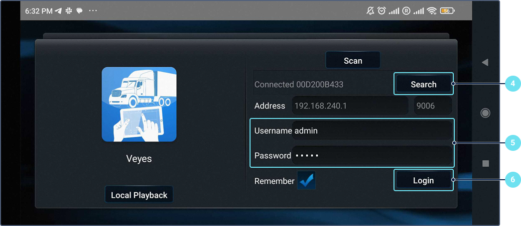

  1. Enable the device Wi-Fi in access point mode: after powering on, the Wi-Fi access point will be available within 3 minutes. Alternatively, double-press the front panel button to activate access point mode.
  2. Enable Wi-Fi on your mobile phone.
  3. Open the Veyes app.
  4. Tap Search to find the Wi-Fi hotspot. Initially, the hotspot name is the device serial number (specified on the device label) or the license plate number if it was configured previously.
  5. Enter the username and password on the login screen. The default credentials are admin for both the username and password.
  6. Tap Login.

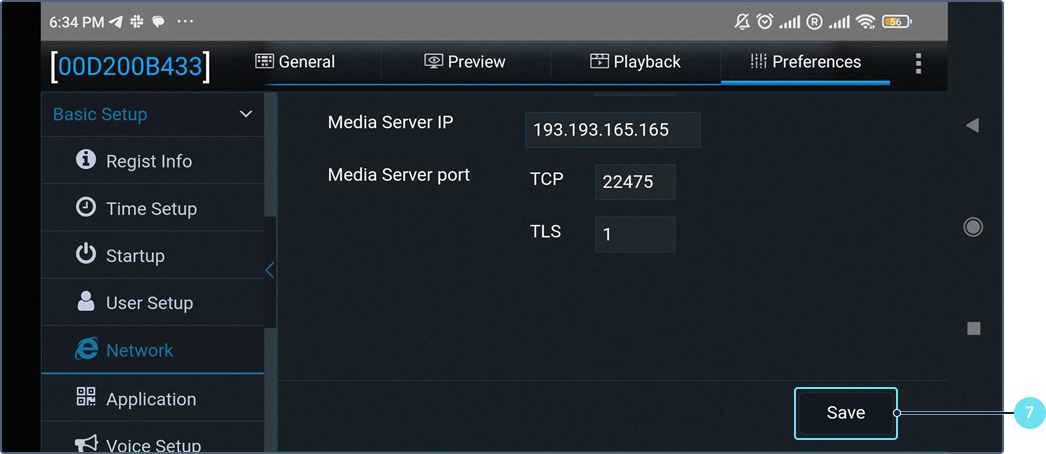

  4. On the Server setup tab, fill in the Register server IP and Register server port fields. For the port, specify 22475. You can find the required IP address and port in the unit properties.
  5. In the Enable network field, select one of the available network types: local, Wi-Fi, communication module, or adaptive. For this guide, the Wi-Fi network type is used.
  6. Set the Media server IP and Media server port fields to the same values as the Register server IP and Register server port fields.
  7. Tap Save.

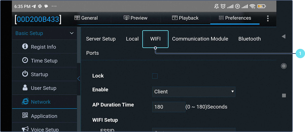

Setting up Wi-Fi

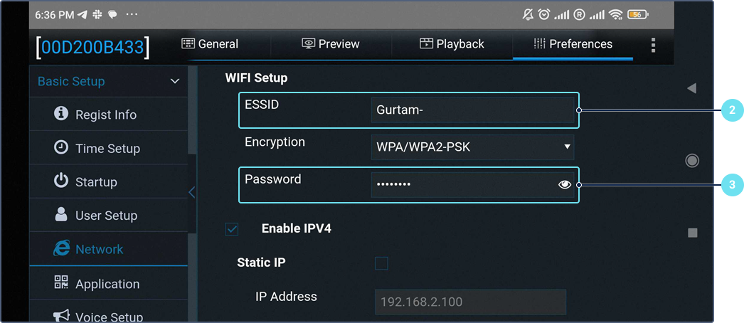

  1. Go to the WIFI tab.
  2. Enter the Wi-Fi point name in the ESSID field.
  3. Enter the password in the Password field.
  4. Tap Save.

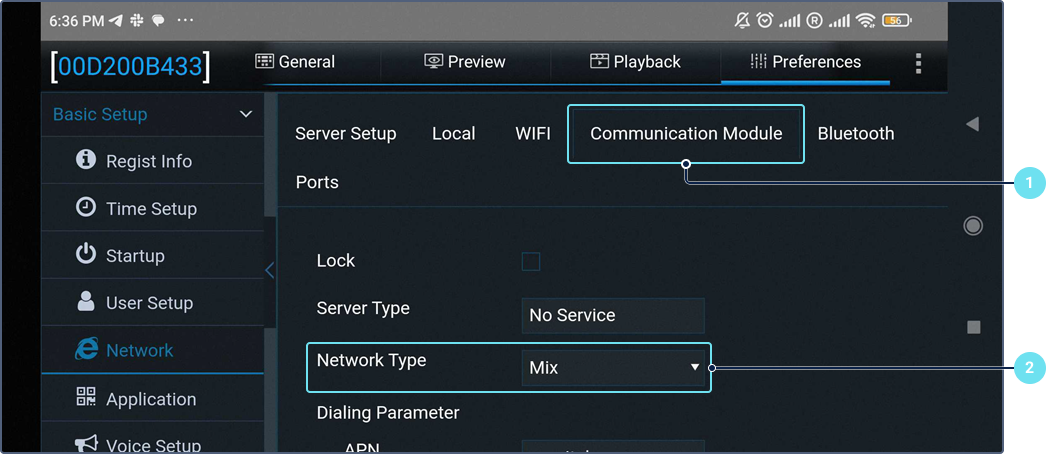

Setting up the cellular network
  1. Go to the Communication module tab.
    After inserting the SIM card, the server type is displayed automatically.
  2. Select the network type as required. The available types are 2G, 3G, 4G, Mix.

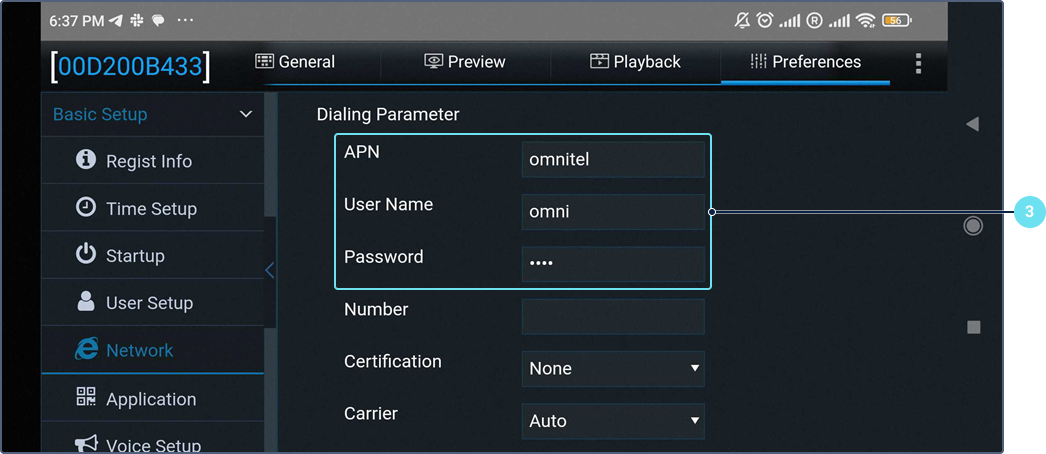

  3. Specify the APN settings, including the APN, username, and password as provided by your mobile operator.
  4. Tap Save.

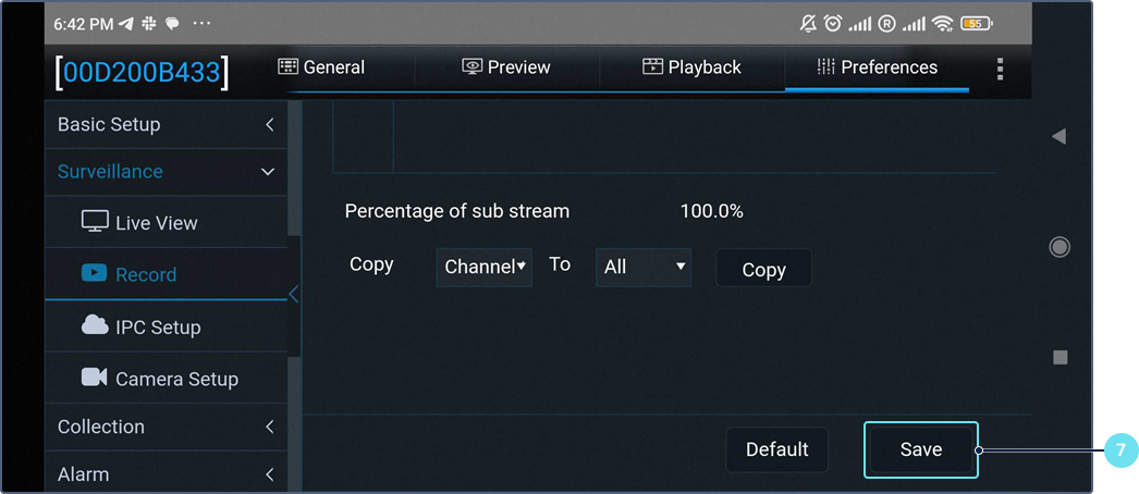

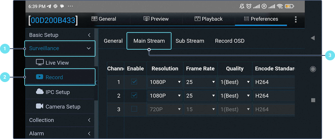

  1. Expand the Surveillance section.
  2. Select Record.

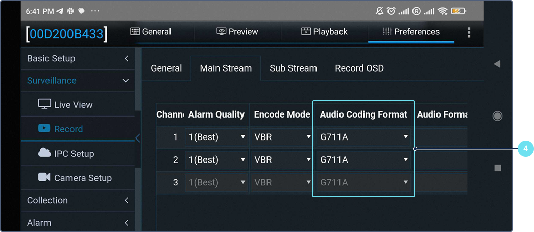

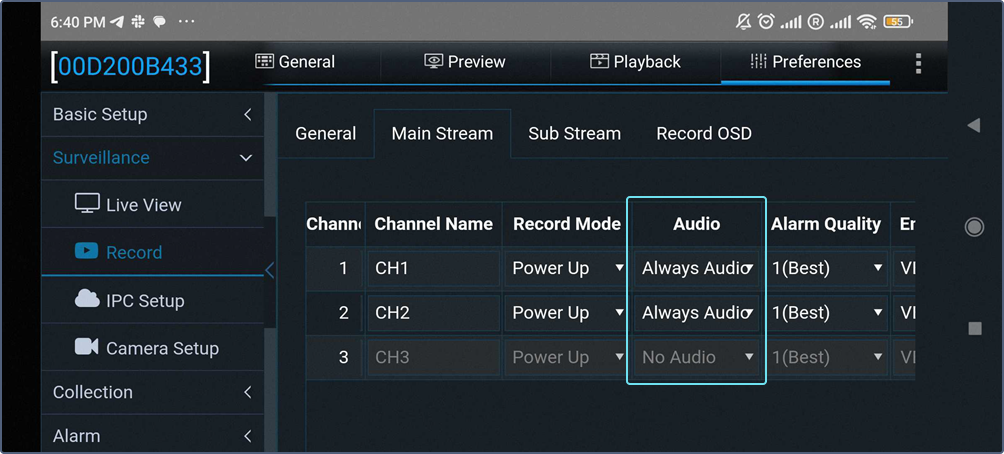

  3. On the Main stream tab, configure video quality settings for the main stream. Audio options include Always audio and No audio, with Always audio as the default.
  4. Set the audio coding format to G711A.
  5. Tap Save.

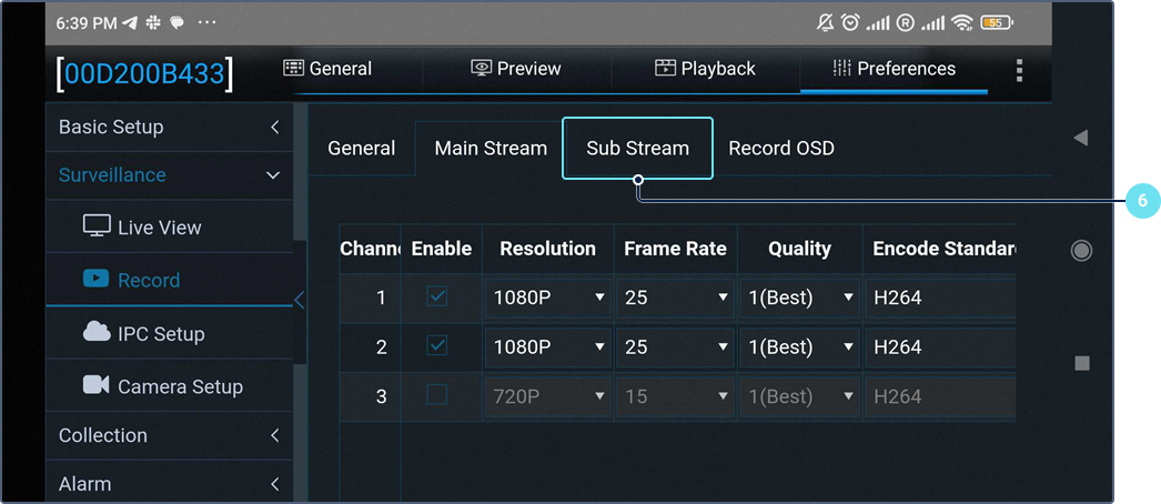

  6. On the Sub stream tab, configure video quality settings for the sub stream.
  7. Tap Save.

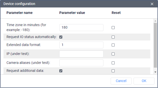

Additional device settings are available in the unit properties upon clicking on the icon  next to the Device type field.
The available settings are as follows:
Setting Description
Time zone in minutes (for example: -180) Here you can specify the time zone of the device in minutes. For example, for UTC+3 enter 180, and for UTC-5 enter -300. The time zone affects video playback requests and message registration.
Request IO status automatically Enable this option to request the IO status automatically after every message with GPS data.
Extended data format Here you can specify the format of the data sent by the device. The possible formats are described below.
IP (under test) Deprecated setting. Leave this field blank.
Camera aliases (under test) Deprecated setting. Leave this field blank.
Request additional data Enable this option to query additional data using the QUERYDEVGENERALSTATUS and GETDEVINFOSTATUS reguests.
