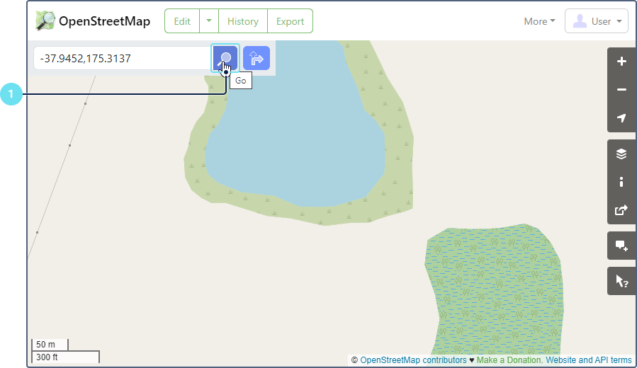

  1. Search for the desired road segment with the help of your mouse. If you know the coordinates of the road segment, enter them in the Search field.

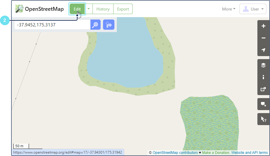

  2. Click Edit.

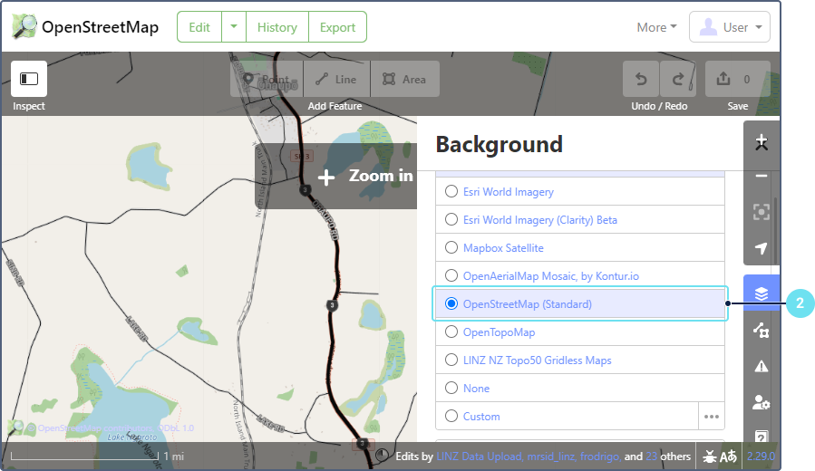

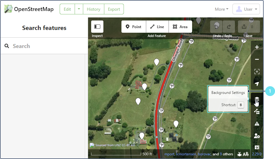

  1. Change the background of the map. To do this, go to the Background settings by clicking on the icon in the right working area (or press B on the keyboard).
  2. Change the satellite image or turn on the OpenStreetMap (Standard) display mode.

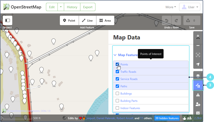

  3. Disable the display of certain data types on the map. To do this, click on the Map Data icon (or press U on the keyboard).
  4. Open the Map Features tab. Remove the unnecessary information from the map.

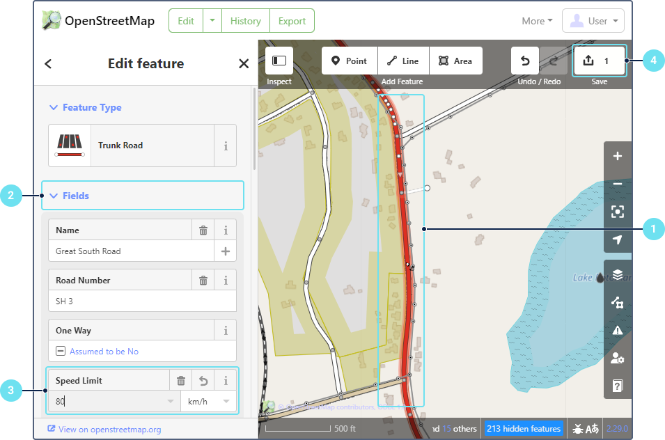

To set a speed limit for the road, follow these steps:
  1. Click on the segment of the road you are interested in. The selected segment will then have a red blinking outline.
  2. Expand the Fields tab if it doesn’t open automatically.
  3. Add or edit the existing speed limit in the Speed limit field. Select the unit of measurement.
  4. Click Save (or press Ctrl+S on the keyboard).

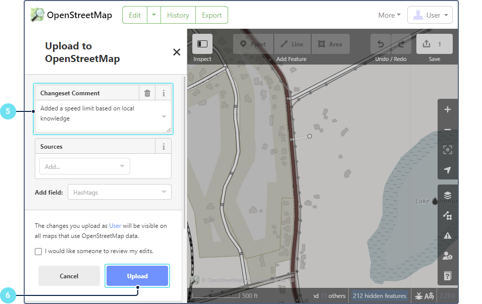

  5. Write a comment on your edit so that other OpenStreetMap users can understand what changes were made. Carefully review your changes.
  6. Click Upload.
  7. Copy the link that appears after uploading and send it to support@online.stavtrack.kz. If you have made several edits, you can report your OpenStreetMap username and coordinates of the places where the changes have been made.
