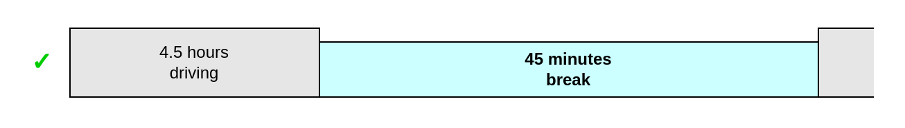

    Example 1. The driver drove for 4.5 hours and then took a break for 45 minutes. In this case, there are no violations.

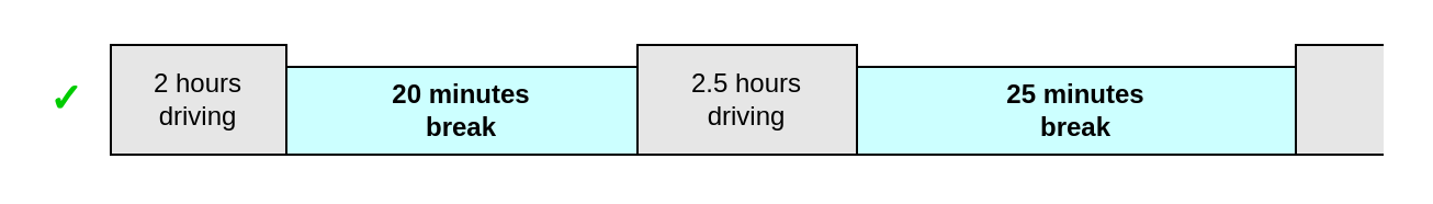

    Example 1. The driver drove for 2 hours, took a break for 20 minutes, then drove for another 2.5 hours and took a break for 25 minutes. In this case, there are no violations, since in total there were 45 minutes of rest for the 4.5-hour driving period.

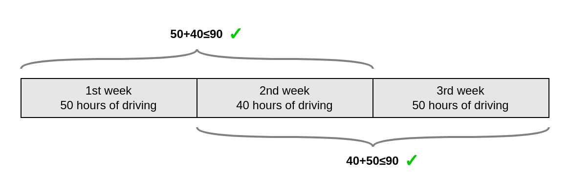

    Example 1. The driving time in the first week was 50 hours, in the second — 40 hours, and in the third — again 50 hours. In this case, there are no violations, since in each individual week the limit of 56 hours was not exceeded, and in total for each two consecutive weeks the limit of 90 hours was met.

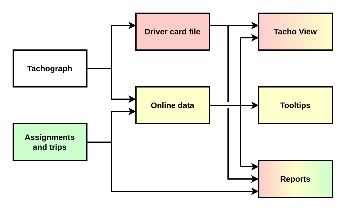

In Wialon, not only the tachograph can be the source of information on DWH. The following diagram will help you understand presented in the system sources and options for displaying DWH information.
Sources of DWH information
The information on DWH displayed in Wialon can be obtained from several sources.
Driver card file
Files with different data are stored in the tachograph memory. The information on DWH of a particular driver is stored on their card. There are different ways to upload a file from a driver card to Wialon, depending on the tracker model:
  • Using commands — in the FAQ section, you can find instructions on how to do this. Such a method is available for trackers that are displayed in the list of supported devices by the Tachograph file download filter.
  • Using third-party software, for example, by connecting the tracker to a computer. Next, you should upload the file to Wialon via the TachoManager web application, and when uploading, select to which driver it belongs.
As a result of each of the actions described above, Wialon will have a file from the driver card, which will be associated with the Driver element.
A file from the driver card is the only reliable source for displaying tachograph information in Wialon. The controller sees data from the same source when checking the tachograph readings on the road.
Assignments and trips
The tachograph determines the work mode by the speed of the vehicle, the ignition status and the presence of a card in the slot. Wialon contains this data without the tachograph as well: trips detector that can be calculated based on the ignition sensor and speed, and assigning/separating drivers. Therefore, driver activity can be determined by messages from the tracker, even if the tachograph is not installed on the unit.
Assignments and trips can only be used as a rough estimate of the DWH compliance. Unlike the tachograph, which determines the current work mode in real time, drivers’ assignments/separations and trips in Wialon are determined by messages from the tracker recorded at a certain frequency, which is less than that of the tachograph.
Online data
The procedure of uploading files from the driver card to Wialon takes time, which is not always convenient. However, users may need real-time DWH information. To satisfy this demand, Wialon created an algorithm, the data source for which is selected on the Advanced tab:
  • Parameters from tachograph, which the tracker determines according to the current tachograph mode. At the moment of this writing, such a capability is only implemented in trackers manufactured by Sensata INSIGHTS (ex-BCE), RuptelaTeltonika, and Navtelecom.
  • Assignments and trips from Wialon.
The online data calculated from any of the sources is associated with the Driver element.
Online data can only be used as a rough estimate of the DWH compliance. Unlike the tachograph, which has an algorithm for recalculating previous intervals, Wialon saves online data without further recalculation.

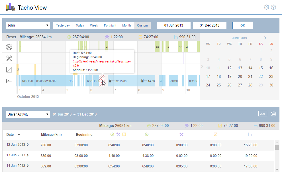

Tacho View
The Tacho View web application visualizes DWH information in the form of color charts and reports on driver activity or labor routine violations.
The information source for displaying is selected in the application settings, and it can be a file from the driver card or online data.

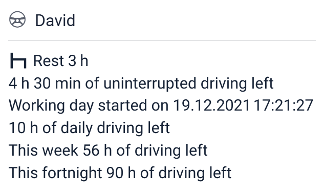

To use this method, you should first enable the Driver activity by online data option in the general user settings.
When hovering over a driver, the information on DWH and violations will be displayed in a tooltip.
The same information will be displayed in the unit tooltip and extended unit information, if the display of drivers in the mentioned places is selected in the user settings and the driver is assigned to this unit.
The source of information for this way of displaying is always online data.
