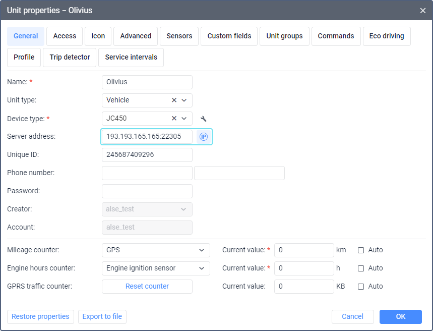

  2. Use the command SERVER,Server_adress,22305,NA,NA,NA,NA to set the server address. You can find the server address and port in the units properties.

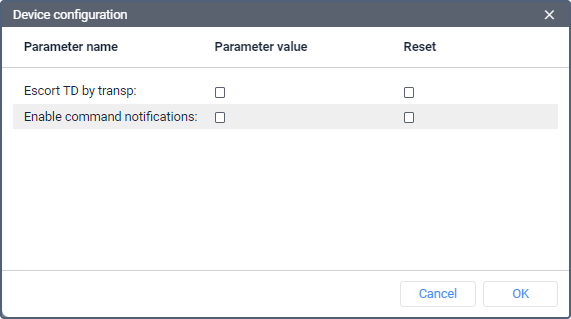

Additional device settings are available in the unit properties upon clicking on the icon  next to the Device type field.
The available settings are as follows:
SettingDescription
Escort TD by transp
Enable this option if you want to receive data from Escort TD additional equipment.
Enable command notifications
Enable if you want to receive command responses in a pop-up window.

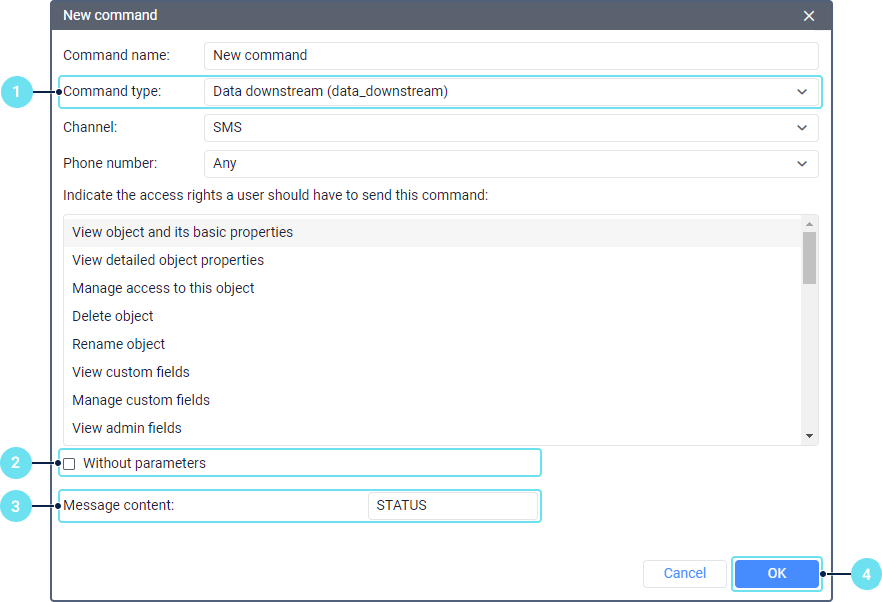

After the device is connected to Wialon, you can use commands to change certain settings in the device configuration. To configure a command, follow the steps below.
  1. Create a command of the Data downstream (data_downstream) type.
  2. Disable the Without parameters option.
  3. Type the command text in the Message content field. For example, to receive the device status, type the text STATUS. To obtain the full list of available commands and their texts, contact the device manufacturer.
  4. Save the created command.
