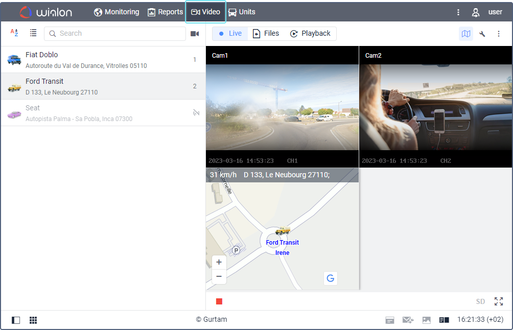

On this tab, you can receive live streams from the unit cameras, watch saved video files, request videos for the past period, and work with them.
To work with video, select the required tab.
Tab
Function
Live stream
Watching live streams from the unit cameras and monitoring the unit movement on the map.
Files
Viewing and deleting the saved files.
PlaybackRequesting a playback for the past period and saving the required excerpts as files.
