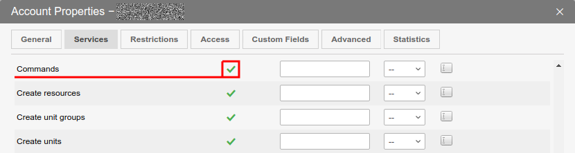

  1. The Commands service is enabled in the account.

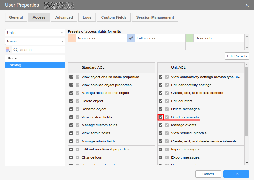

  2. The user has the Send commands special right regarding the unit.

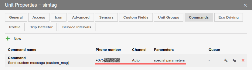

  3. The command is created in the same-name Commands tab in the unit properties.
    To create commands, the user must have the Create, edit, and delete commands special right regarding the unit.

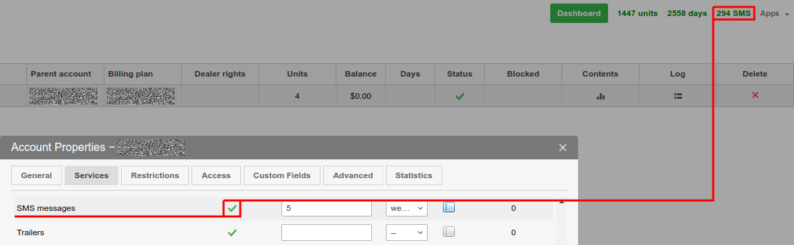

  4. There are several additional conditions for executing commands over the SMS channel:
    • The SMS messages service is enabled in the account.
    • SMS must be available in the service, i.e., the counter on the top panel must be greater than zero.
      This counter is not displayed if the service uses a personal modem for sending SMS.

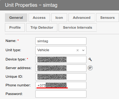

    • In the General tab in the unit properties, you must specify the Phone number in international format, to which the tracker will receive SMS.
