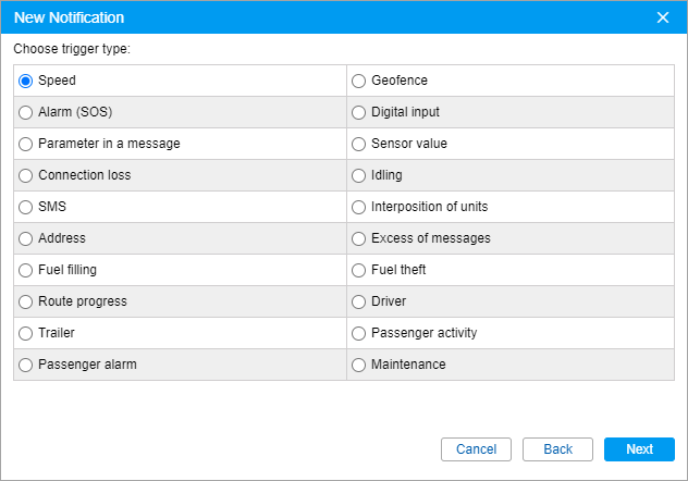

Notification Types
There are different conditions for triggering notifications.

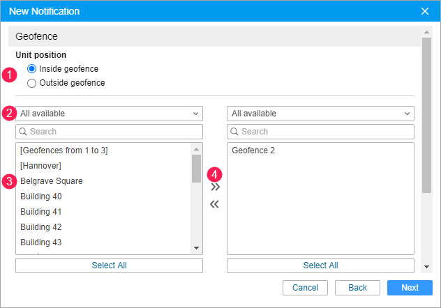

Below are the steps to configure a notification of the Geofence type.
Select when the notification should be triggered:
- when the unit enters the geofence (Inside geofence);
- when the unit leaves the geofence (Outside geofence).
Select the resource whose geofences should be displayed in the list (select All available to view the geofences of all available resources).
In the left list, select the geofences or groups of geofences (displayed in square brackets) for which the notification should be triggered. You can use the dynamic filter above the list to search.
Using the icon
, move the items from the left list to the right one.

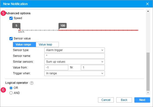

In the Advanced options section, if necessary, specify the additional conditions under which the notification should be triggered. It can be the range of speed values (the Speed option), and/or the range or the difference of the selected sensor values (the Sensor value option).
Select the logical operator on the basis of which the notification should be triggered if several geofences are selected. The OR and AND operators are available.
Logical operators for a unit inside the geofence
Logical operator | Description |
OR | The notification is triggered when the unit enters any of the selected geofences. |
AND | The notification is triggered when the unit is in all the selected geofences at the same time. |
Logical operators for a unit outside the geofence
OR | The notification is triggered when the unit leaves any of the selected geofences if it previously has been in all of them at the same time. |
AND | The notification is triggered when the unit leaves all the selected geofences. |

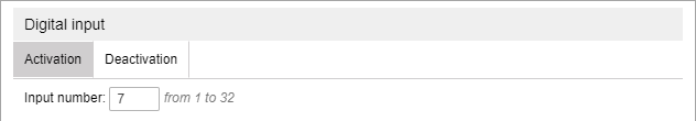

Digital input
Specify the number of digital input and the control type: trigger in case of its activation or deactivation. If the message does not have the I/O parameter, the io_n parameter is analysed.

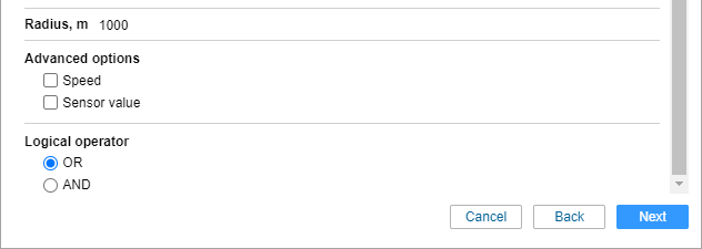

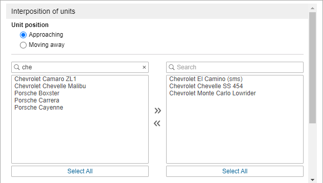

Interposition of units
This notification allows you to control the interposition of units: their approaching and moving away from each other. Select the criterion (approaching or moving away) and transfer from the left list to the right one the units whose approaching or moving away should trigger the notification. You can use the dynamic filter above the list to search.
Specify the settings described below.
Setting | Description |
Radius, m | The distance between the units with decreasing or increasing of which the notification should be triggered. |
Advanced options | Filters for speed and sensor value. |
Logical operator | The value on the basis of which the notification is triggered. If OR is selected, the notification is triggered when the unit approaches or moves away from any of the selected units. If the logical operator AND is selected, the notification is triggered when the unit approaches or moves away simultaneously from the marked units. |
The interposition of units is checked by the system using the latest messages only.

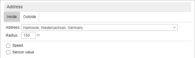

Address
This type of notification is similar to geofence control. It allows you to control the entrance/exit or being in or out of a particular place. Enter some address parameters (e.g. city, street, and house) and then select the most appropriate option from the found addresses. Also, specify the radius of the point. In addition, filters for the sensor and speed can be applied.

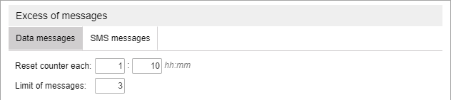

Excess of messages
With this type of notification, you can be warned if a unit exceeds the limit of messages you have set. This can be either ordinary data messages or only SMS messages. Indicate the limit of messages and set the reset interval. For example, if you configure a notification, as shown in the example below, the notification will trigger if the unit sends 3 or more SMS messages within 1 hour 10 minutes.

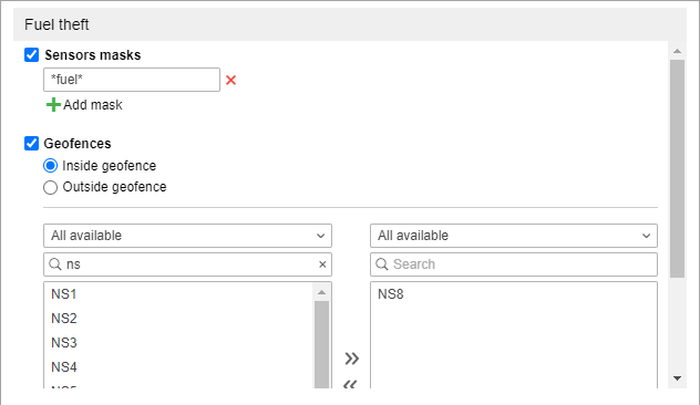

Fuel theft
Notification of this type allows you to monitor fuel thefts. When creating a notification, you can specify the sensor masks that should be used to estimate fuel thefts and their volume. Also, using the Inside geofence and Outside geofence options, you can monitor fuel thefts for certain geofences (must be created in advance). Select the resource whose geofences should be shown in the list (select All available to view the geofences of all available resources). Also, choose the geofences or groups of geofences (shown in the square brackets), for which this notification should work. For the search convenience, you can use the dynamic filters above the lists.
The notification is triggered after a fuel theft is detected. To receive the notification only once, it is necessary to activate the Ignore recalculated data option.
Notification is triggered for each fuel level sensor individually.

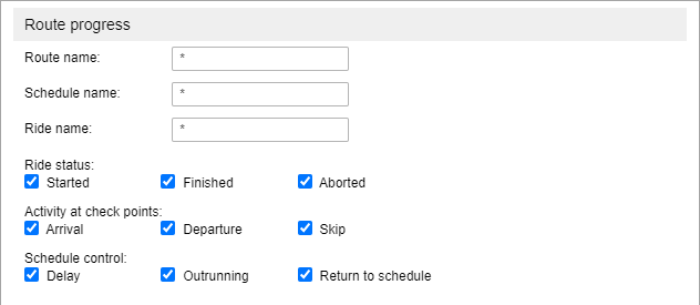

Route progress
For this type of notification, select the statuses to control: ride start, ride finish, arrival to check point, check point skip, departure from check point, etc. Additionally, you can specify a name mask for a route, schedule and/or ride.

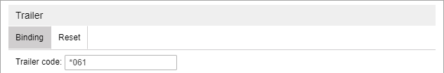

Trailer
Choose control type: trailer assignment or reset. Settings to adjust are the same as for the previous type.

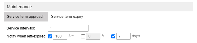

Maintenance
First, you choose trigger type: notify when service term approaches or notify when service term is expired. Then indicate the interval before or after the term for the notification to trigger. This interval can be in days, kilometers, engine hours, or together. You can control either all intervals existing in the Service intervals tab in unit properties or just several intervals. To specify target intervals, enter a name mask using wildcard symbols like an asterisk (*) and question sign (?). Then indicate how much mileage, or time, or how many engine hours should be left or expired to make the notification trigger.
Notification about maintenance triggers only once when a critical point is met (mileage, engine hours or time) about any maintenance interval. Then information about service work done should be delivered through the event registrar or through the unit properties dialog. Only after that, the notification starts working again.
Below are the notifications’ triggering peculiarities.
If upon creation of notification a unit with an already exceeded maintenance interval is chosen, then the notification for such a unit will not trigger.
If no position messages have been sent to a unit, then the notification for such a unit will not trigger.
As each notification belongs to some resource, it takes its measurement units from this resource. If the American or imperial measurement system is set for the resource, then speed is shown in miles per hour (mph), radius in feet (ft), and mileage in miles (mi). Otherwise (in case of the metric system), it will be kilometers per hour, meters and kilometers, correspondingly.
