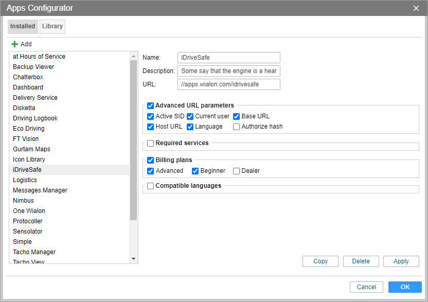

Applications can be managed only by top users. The Apps configurator item of the user menu allows you to do this. Click on this item to open the Apps configurator dialog. It contains two tabs: Installed and Library. On these tabs, you can have a look at all the available applications, as well as configure and add new ones.
Installed
A list of added apps can be found on the Installed tab. To add a new application, click Create and indicate the information described below.

Advanced URL parameters
If necessary, select advanced URL parameters. It is required to enable the Active SID or Authorize hash option so that users can log in to the application.
Advanced parameter
Description
Active SID
Enable this option to configure authorization by SID. With this authorization type, the user is not logged out of the application after a page refresh.
Current user
Enable this option, so that the URL contains the username that was used to log in to the application. It might be helpful, if the user logs in to Wialon using the Log in as button.
Base URL
Enable this option to add API address to the URL. For example, hst-api.online.stavtrack.kz
Host URL
Enable this option so that the URL contains the address from which the user accessed the application. For example: hosting.online.stavtrack.kz
Language
Enable this option if you want the application interface to be in the same language that is selected in the user settings in Wialon.
Authorize hash
Enable this option to configure authorization by hash. With this authorization type, the user is logged out of the application automatically after a page refresh.

**Required services
**Select services (features) which are required for the default activation of the application. If the list of features available to a user does not match this list (or if you leave this section empty), the application is disabled for the user.
**Billing plans
**Select the billing plans for which this application should be available.
**Compatible languages
**You can restrict access to the application for various interface languages. For example, if the Russian language is selected, this means that the application is available only when the Russian language of the interface is selected. If nothing is selected, it is assumed that the application should be available to all languages.
After setting all the parameters, press Add and when closing the dialog click OK to save the changes.
Operations with applications
To edit an application, select it on the left, change the parameters, press Apply, and then, when closing the dialog, click OK.
To delete an application, select it on the left and press Delete. Then, when closing the dialog, click OK.
To create a new application by copying, select the sample application on the left and press Copy. Edit the parameters, click Apply, and then, when closing the dialog, click OK.
To ignore all the changes made, press Cancel.

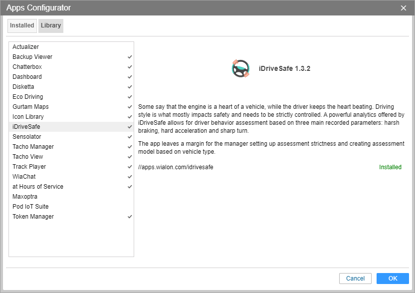

Library
On the Library tab, you can select a suitable application and add it with a single mouse click. Adding application from the library is a little bit easier as all the mandatory parameters and the advanced URL parameters are indicated by default.
The list of applications is on the left. To the right of the list is a field that displays the current information for the application selected in the list. This information includes the following: application icon, its name, short description, URL, and release date. To add an application from the library, you must select it from the list. Then, if this application is not already installed, the Add button is activated below the description. To complete the procedure click Apply and then OK.
See also Wialon apps review.
