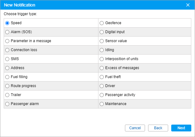

Notification Types
There are different conditions for triggering notifications.

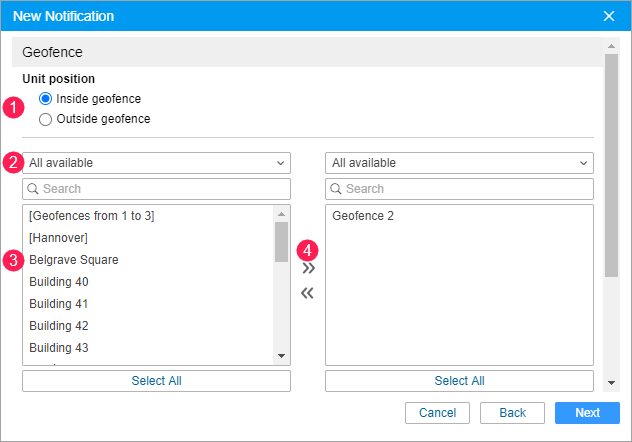

Geofence
Below are the steps to configure a notification of the Geofence type.
Select when the notification should be triggered:
- when the unit enters the geofence (Inside geofence);
- when the unit leaves the geofence (Outside geofence).
Select the resource whose geofences should be displayed in the list (select All available to view the geofences of all available resources).
In the left list, select the geofences or groups of geofences (displayed in square brackets) for which the notification should be triggered. You can use the dynamic filter above the list to search.
Using the icon
, move the items from the left list to the right one.
In the Advanced options section, if necessary, specify the additional conditions under which the notification should be triggered. It can be the range of speed values (the Speed option), and/or the range or the difference of the selected sensor values (the Sensor value option).
Select the logical operator on the basis of which the notification should be triggered if several geofences are selected. The OR and AND operators are available.
Logical operators for a unit inside the geofence
Logical operator | Description |
OR | The notification is triggered when the unit enters any of the selected geofences. |
AND | The notification is triggered when the unit is in all the selected geofences at the same time. |

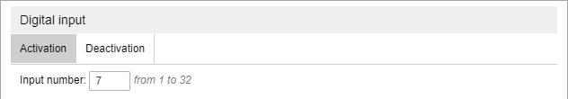

Digital input
Specify the number of digital input and the control type: trigger in case of its activation or deactivation. If the message does not have the I/O parameter, the io_n parameter is analysed.

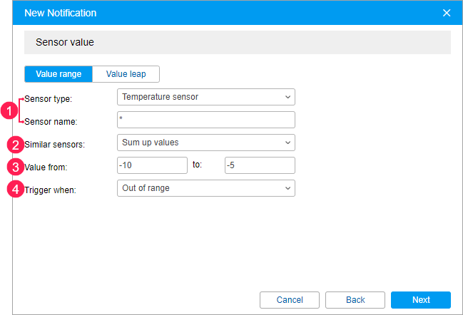

Sensor value
For a notification of this type, two control methods are available:
- Value range. Allows specifying a range of sensor values to control whether the received values fall in it or not.
- Value leap. Allows specifying one value to control whether the received values exceed it or not.
For the Value range method, follow these steps:
- In the drop-down list, select the sensor type and/or in the Sensor name field, specify the name mask using special characters (* and ?).
- In the Similar sensors drop-down list, select one of the available options:
- Sum up values. The values of all sensors of the selected type and/or sensors with the same name mask are summed up. Thus, the sum of all values is taken into account before the notification is activated.
- Calculate separately. The values of all sensors of the selected type and/or sensors with the same specified name mask are controlled separately.
- Specify the minimum and maximum values of the sensor.
- Select the activation type:
- In range. The notification is activated when receiving values which fall in the specified range, including the values specified as minimum and maximum ones.
- Out of range. The notification is activated when receiving values which don’t fall in the specified range.

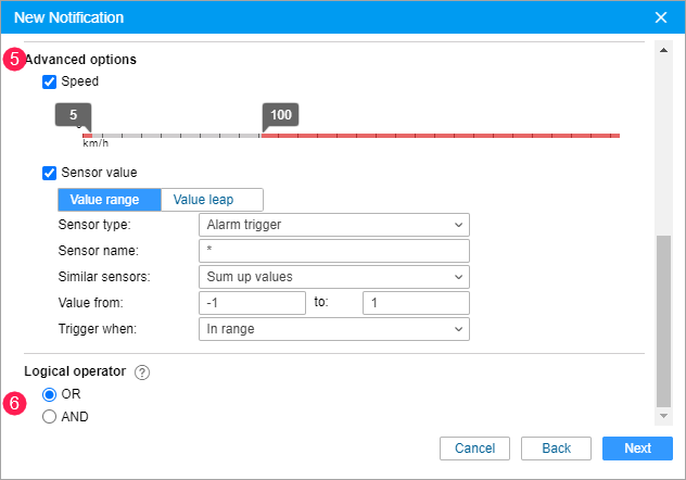

If the Sensor value option is activated, the notification is triggered only if all the specified conditions are met: off time duration, speed, and the sensor value. For example, you can receive notifications when the unit is parked with the engine or attachments running. This option is configured in the same way as the notification type of the same name.
Also, whether the unit is inside or outside a certain geofence can be an additional condition for triggereng the notification. For this purpose, enable the Geofence option and configure the settings described in steps 1—4 in the same-name notification type.

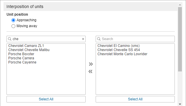

Interposition of units
This notification allows you to control the interposition of units: their approaching and moving away from each other. Select the criterion (approaching or moving away) and transfer from the left list to the right one the units whose approaching or moving away should trigger the notification. You can use the dynamic filter above the list to search.
Specify the settings described below.
Setting | Description |
Radius, m | The distance between the units with decreasing or increasing of which the notification should be triggered. |
Advanced options | Filters for speed and sensor value. |
Logical operator | The value on the basis of which the notification is triggered. If OR is selected, the notification is triggered when the unit approaches or moves away from any of the selected units. If the logical operator AND is selected, the notification is triggered when the unit approaches or moves away simultaneously from the marked units. |
The interposition of units is checked by the system using the latest messages only.

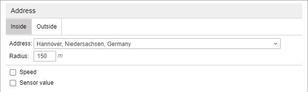

Address
This type of notification is similar to geofence control. It allows you to control the entrance/exit or being in or out of a particular place. Enter some address parameters (e.g. city, street, and house) and then select the most appropriate option from the found addresses. Also, specify the radius of the point. In addition, filters for the sensor and speed can be applied.

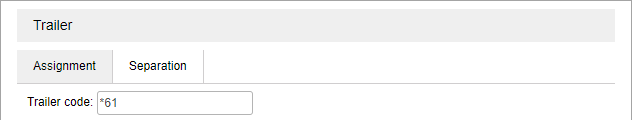

Trailer
Choose control type: trailer assignment or separation. Settings to adjust are the same as for the previous type.
