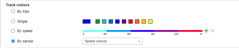

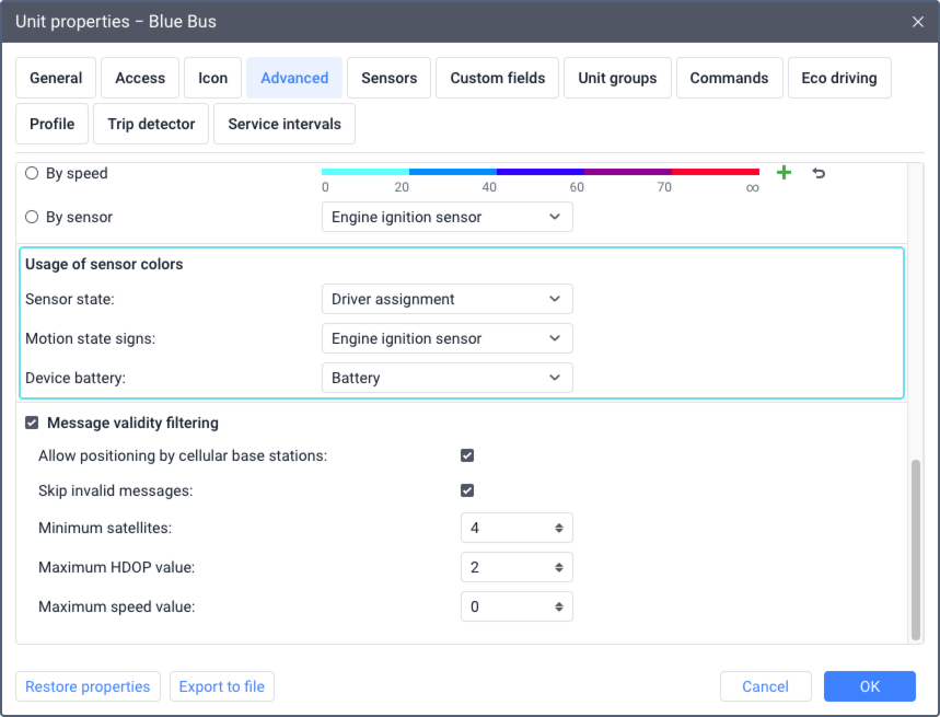

View object and its basic propertiesTo see Unit caption color, Track color and Usage of sensor colors sections
View detailed object propertiesTo see the Additional settings section, Message validity filtering and driver activity source.
Edit not mentioned properties
To edit the Unit caption color, Track colors, Usage of sensor colors sections.

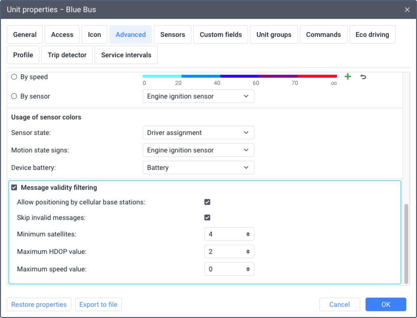

Edit connectivity settings
To edit the parameters of message validity filtering and Speed source section.

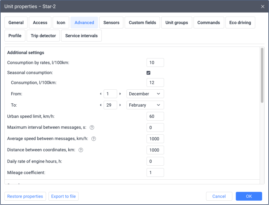

Additional settings
The parameters available in this section influence the calculations of fuel consumption, mileage, engine hours and other data.
ParameterDescription
Consumption by rates
Fuel consumption per 100 kilometers. Another unit of measurement can be used, depending on the selected measurement system. The default value is 0.
Seasonal consumption
The option which allows you to specify a separate fuel consumption rate for a certain period. The default value is 0.
If the Seasonal consumption option is activated, then when you create a new sensor using the math consumption wizard, the Seasonal coefficient, % option is activated there by default. The value of the coefficient is calculated in accordance with the values specified on the Advanced tab.
Urban speed limit
The maximum speed at which it is conventionally considered that the unit is moving within the city. Moving at a higher speed is considered as suburban mileage. You can use this setting in reports: in the Trips table, in statistics, in the advanced report on drivers.
Maximum interval between messages
The maximum interval between messages in seconds.
If the time difference between two messages exceeds the specified value, such a time interval is considered a connection loss. You can view the intervals of no connection in the Connection problems report.
The option can affect:
  • the calculation of fuel consumption by maths and FLS;
When determining engine hour intervals, the option is used if its value is smaller than the value specified for the Timeout option of the sensor. When determining fuel filling and drain intervals, the option is used if its value is smaller than the value of the Minimum parking time option.
  • the determination of engine hour, fuel filling and drain intervals;
  • the display of tracks and charts: the lines are interrupted where the specified value has been exceeded.
The default value is 0 (option disabled).
Average speed between messages
This option is used to exclude coordinate outliers when calculating mileage.
Maximum average speed of the unit determined by two successive messages, in km/h. If the specified value is exceeded, these messages are not taken into account when calculating the mileage in reports, in the GPS and GPS + engine ignition sensor mileage counter and on the Messages tab.
To disable the option, specify 0.
Distance between coordinates
Maximum distance between coordinates in two successive messages, in km. If the specified value is exceeded, these messages are not taken into account when calculating the mileage in reports, in the GPS and GPS + engine ignition sensor mileage counter and in the Messages tab.
  Daily rate of engine hours
The daily rate of engine hours (in hours). This value can be used in the report on engine hours (when calculating utilization and useful utilization). The operation of engine hours is determined by the engine hours counter.
Mileage coefficient
The coefficient used to correct the mileage calculated in Wialon in cases where it always differs from the actual mileage by a certain number of times.
Example. The mileage calculated in Wialon is 100 km, and the actual mileage (determined by the vehicle equipment) is 120 km. The mileage coefficient that should be specified in this field is 120/100 = 1.2.
The result of multiplication by the coefficient is shown in the Mileage (adjusted) column in different report tables and statistics.

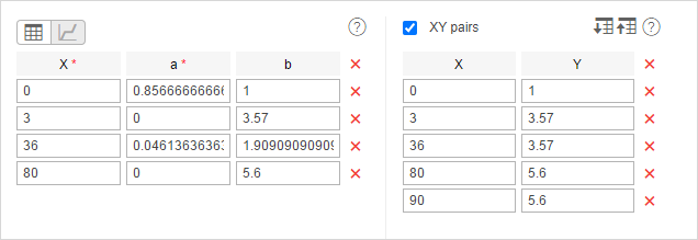

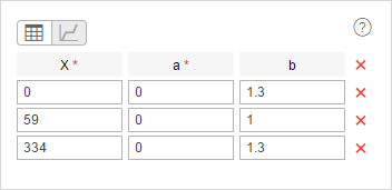

How is the seasonal coefficient calculated?
As a rule, the seasonal coefficient supposes increased fuel consumption. For instance, the consumption in winter is 30% higher than in summer. Let us suppose, that the winter in your climate is from December, 1 to March, 1.
  1. Create an engine efficiency sensor with the parameter time:d.
  2. Find out which numbers of the day in the year do your dates correspond to. High precision is not obligatory: a year may be a leap one and the season itself may be longer or shorter. For the period indicated above, for example, the numbers are ‘334’ and ‘59’ approximately.
  3. Create a calculation table as seen in the screenshot below.
time is the parameter that is present in any message from any device, and the system will calculate the number of the day automatically on its basis. In that way, as the season starts, 30% will automatically be added to the fuel consumption.

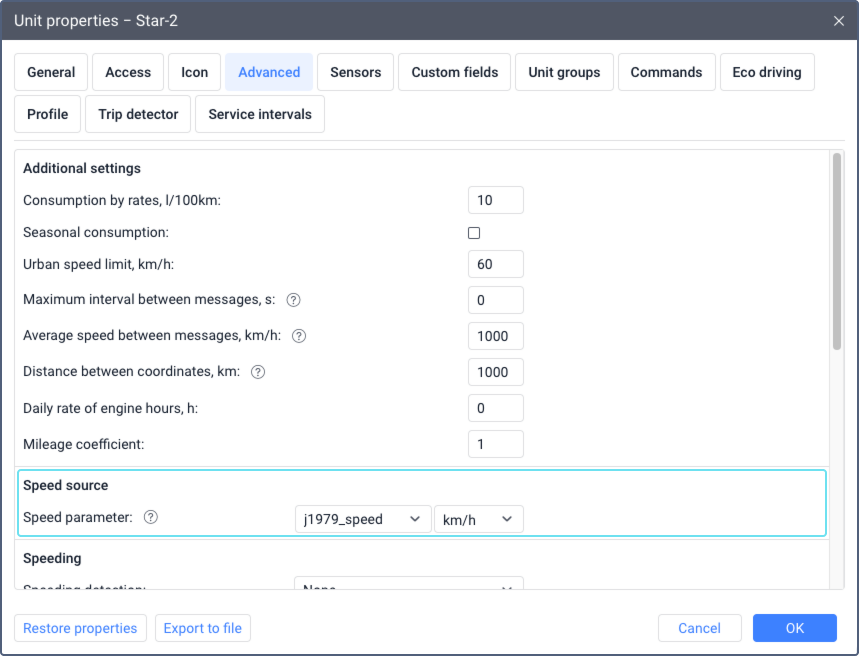

Speed source
This section is shown for certain device types for which changing the speed source is supported in the monitoring system.
In most cases, the monitoring system uses the values calculated by the device via GPS as speed values. They are stored in the unit messages in the speed parameter. If they are not correct, you can specify the parameter the values of which should be used for the speed parameter.
To set the speed source correctly, follow the steps below.
  1. In the Speed parameter field, select or specify the name of the parameter (no more than 50 characters) the values of which should be used as speed values. The list shows all the parameters sent by the device, except for the virtual ones.
  2. Select the unit of measurement in which the device sends speed values (not the unit of measurement which should be shown in the monitoring system). If the unit of measurement is not selected, the system uses km/h.
  3. Save the changes.
After that, the speed value is taken from the specified parameter.
After that, the speed parameter values from the unit messages begin to be replaced by the values of the specified parameter in all parts of the system without the possibility of recovery. If the messages don’t contain the specified parameters, the usual values of the speed parameter are used.
The speed value of the specified parameter is not taken into account in the system if the location is determined by LBS (see the Allow positioning by cellular stations option). Namely, the unit tooltip, the extended unit information and the Speed column in messages show 0.

Track colors
In this section, you can set the color for tracks, that is, the lines of unit movement on the map. The tracks are mapped on the Tracks, Messages, Reports, and Monitoring tabs (the Quick track option).
Tracks can be single- or multi-colored depending on the settings according to which the color is determined. You can select one of the four options:
  • by trips;
  • single;
  • by speed;
  • by sensor.
ItemDescription
By trips
The track is divided into sections of different colors, each of which corresponds to one trip. Trips are detected by the trip detector.
Single
The track is single-colored. This option is useful when mapping tracks for unit groups because they don't merge with each other in this way. You can select a color from the palette.
If you map several tracks in a row, the next color from the palette is used for each track.
By speed
The track is multi-colored depending on the unit speed. To add an interval, click on the icon , specify the speed values ​​and the color for the interval, and click OK. An empty value in the first field is considered as -∞, in the second as + ∞. You can select the color from the palette or specify it in the HEX format in the field above.
The created intervals are shown on the line scale. To edit an interval, click on it, make changes, and click OK.
To reset the settings to the default ones, click on the icon  to the right of the scale.
By sensor
The track is multi-colored depending on the values of the selected sensor. The list contains the sensors created for the unit. The value intervals and colors for tracks are specified in the sensor properties.
If the interval settings have been deleted from the properties of the selected sensor, the system will automatically switch to another sensor that has the intervals configured. In case there are no other sensors with configured intervals, the system will use the By trips option.
In this section, you can select the sensors the colors of which should be used for certain interface elements. A sensor is available for selection after you create it and specify its value intervals  and the colors corresponding to them.
Below are the interface elements for which the colors of the selected sensors are used.
ItemDescription
Sensor state
The colors of the selected sensor are used for the Sensor state option in the work list on the Monitoring tab and in the menu of monitoring options on the map.
Motion state signs
The colors of the selected sensor are used for motion state signs on the map.
Device battery
The colors of the selected sensor are used for the Device battery option in the work list on the Monitoring tab and in the menu of monitoring options on the map.
Also, the sensor selected here is used on the Health check tab for the Device battery level criterion.
To configure a sensor which shows the device battery level, you should create a custom sensor with the parameter in which data on the battery is received from the device. If the data is received in volts, and not in per cent, then you should also fill in the calculation table in the sensor properties so that the data is displayed correctly.
If the unit doesn’t have suitable sensors, these options are inactive.
All messages from units are registered in the database. However, some messages can be invalid, for example, due to data fluctuations or lack of coordinates. Such messages distort the values of mileage, tracks, indicators in reports, etc.
In order for the system not to take invalid messages into account, enable the Message validity filtering option and configure the required criteria: the number of satellites, unit speed, or the accuracy of coordinates. Here you can also enable the options for determining the location by LBS and filtering the messages identified as invalid by the device itself.
Regardless of the settings in this section, any messages with zero or no coordinates are filtered automatically. A message is considered invalid if at least one coordinate (longitude or latitude) is equal to zero.
Filtering is applied only to GPS data, so if an invalid message contains other parameters, for example, sensor values, they can still be used in the system.
The settings in the section apply only to the messages received after the settings have been adjusted.
OptionDescription
Allow positioning by cellular base stations
This option works for devices which support positioning by cellular stations. To see a list of such devices, select the required section on the Hardware tab and apply the LBS filter.
The option allows using cellular base stations (LBS) to determine the unit location, for example, when GPS data is not valid. The data obtained this way is not as accurate as GPS data and shows only an approximate location.
LBS data is used in the following cases:
  • when the Allow positioning by cellular base stations option is enabled and there are no messages with GPS data for more than five minutes;
  • when the Allow positioning by cellular base stations option is enabled and the messages with GPS data received over the last five minutes don't meet the specified filtering criteria.
During these five minutes, the system shows the unit location and motion state determined by the last valid GPS data. The LBS messages received in the meantime don't affect the displayed unit location and motion state, but you can see these messages in reports and in the table of messages.
After five minutes, if the values of all LBS parameters (mnc, mcc, lac, cell_id) remain the same as in the last message with valid GPS coordinates, these coordinates continue to be regarded as the last known unit location and the motion state icon doesn't change. As soon as new values of the LBS parameters are received, a new unit location is shown according to them, and the motion state icon changes to .
If the unit location is determined by LBS, the speed values are not taken into account in the system. In this case, the unit tooltip, the extended unit information and the Speed column in messages show 0.
Messages with LBS data are not taken into account in the trip detector and eco driving.
Skip invalid messages
The option allows ignoring the GPS data identified by the device as invalid. Some devices (controllers) send special parameters which identify invalid coordinates. Also, the current time and the last valid coordinates are specified in the message. The system considers such a message to be without positional data and doesn't use it for mapping tracks, determining the location, and so on.
Minimum satellites
In this field, you can specify the minimum number of satellites that should be used to determine the coordinates in order for the message to be considered valid. The recommended number is at least four. The value can't exceed 255.
Maximum HDOP value
In this field, you can specify the maximum HDOP value with which messages are considered valid. HDOP stands for horizontal dilution of precision. The smaller this value is, the more accurate the coordinates are. The value can't exceed 9,999.
Maximum speed value
In this field, you can specify the limit for speed values. If it is exceeded, the message is considered invalid. You can't indicate a value greater than 9,999. If 0 is specified, this filtering criterion is not taken into account.
If the speed or HDOP value exceeds the maximum allowed one, or the number of satellites is lower than the specified one, the following data of the message becomes unavailable: speed, coordinates, number of satellites, and altitude.
