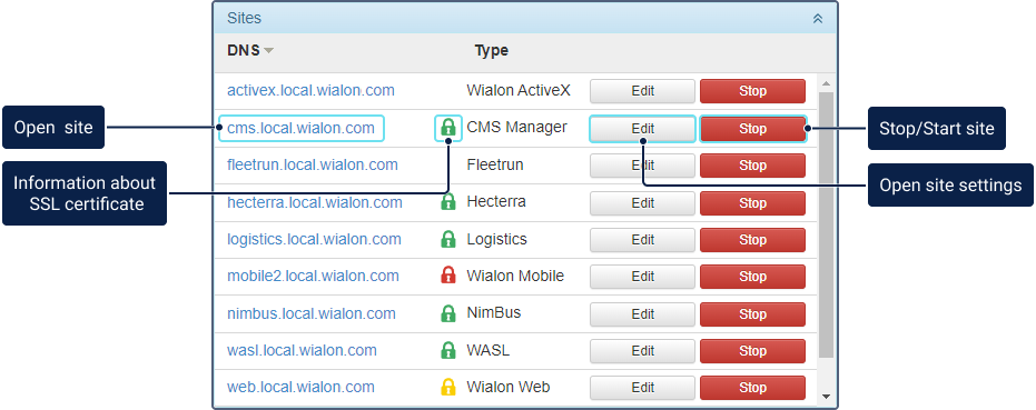

The Sites section is a table where the DNS and type of each site are specified. To open the required site, click on its DNS link.
To open the site settings, click on the Edit button next to its name.
To the right of the Edit button, there is a button to start/stop the site. If you stop the site, the users cannot log in to the system.
After starting (restarting) Wialon Local, all sites are loaded (reloaded) regardless of their previous state.
If a site works using the https protocol, a lock icon is displayed next to its name. In the tooltip of the icon, you can see the information about meeting the requirements for the certificate parameters and the name of the certificate authority (the Issuer line). The colour of the icon depends on the reliability of the SSL certificate.
