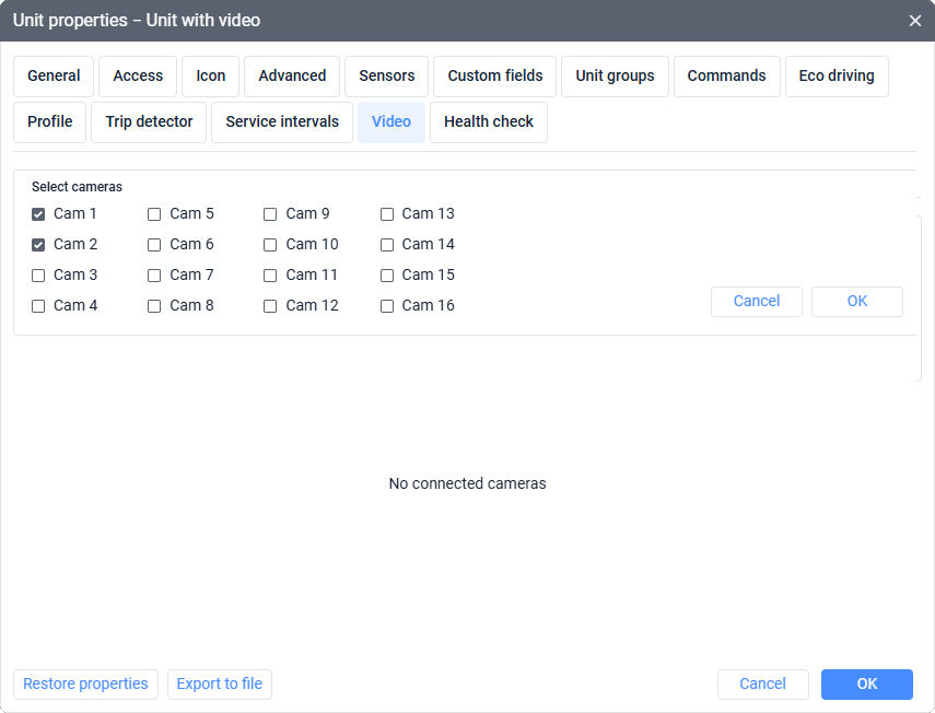

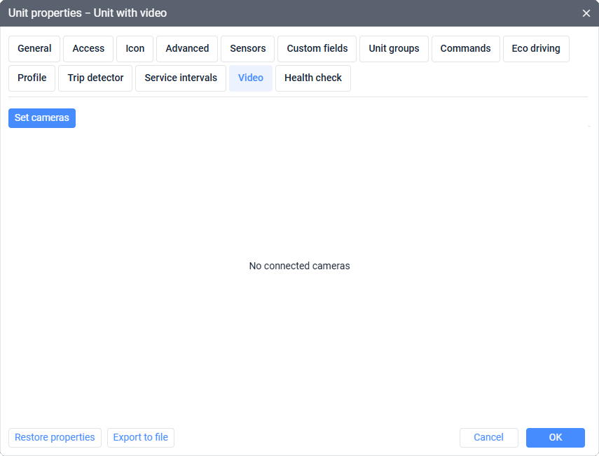

Configuring cameras in the Video tab of the unit properties.
The tab is available in the properties only for the units added to video billing in the CMS Manager.

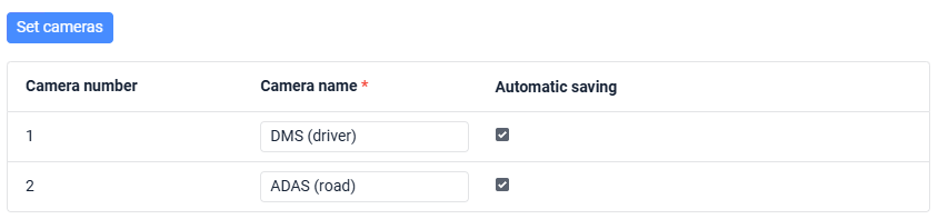

Select the required cameras.

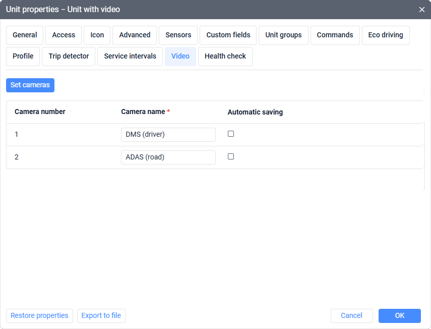

Then, specify their names, making it easier and faster to tell them apart.
You can also enable the Automatic saving option for the chosen cameras. This feature allows you to automatically save a video when a notification with the Save a video as a file action is triggered. If you do not use such notifications, the status of this option will have no effect whatsoever.

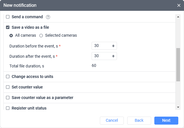

Using a notification with the Save a video as a file action type, you can automatically save a video fragment recorded by the unit’s cameras when the notification is triggered.
The saved file will be available in the Files section of the Video tab, as well as in messages and reports.

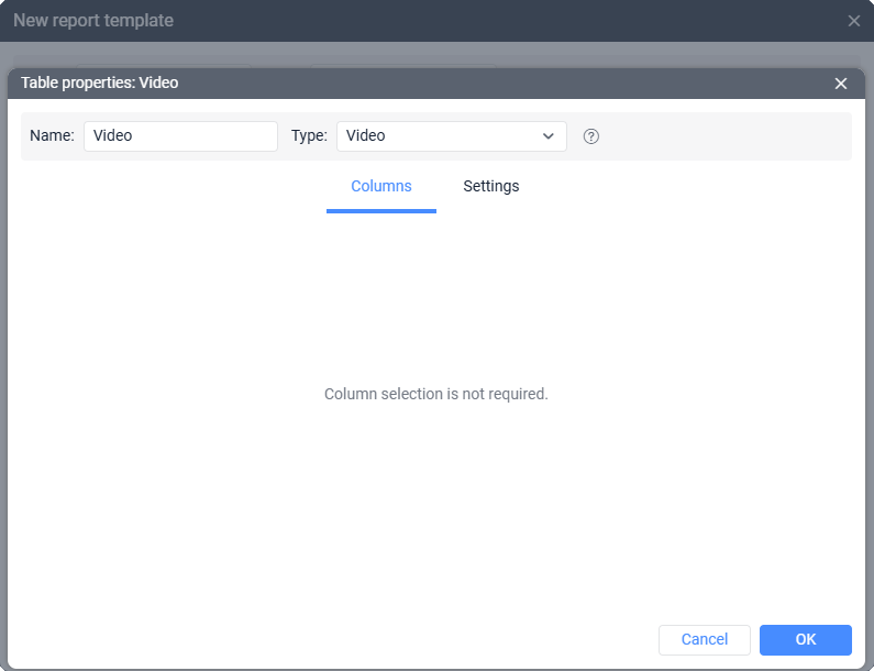

You can view saved video recordings in reports using the Video table.

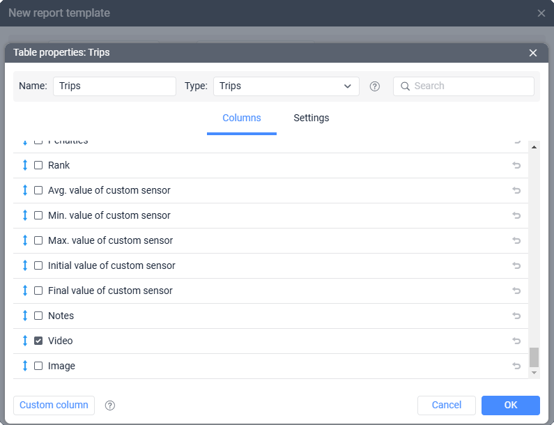

Recordings are also available in the Video column in some tables (for example, Trips, Geofences, Eco Driving, Violations, etc.).
