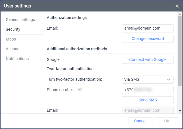

Two-factor authentication

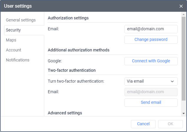

To enable two-factor authentication, in the drop-down menu select the method of receiving the confirmation code: via email or SMS.
Via email
The code is sent to the email address specified in the authorization settings. To confirm the address, do the following:
- Click the Send code button. If you do not receive the code at the address provided, click on the Resend code button. The option is available every 30 seconds.
- Enter the received code in the Verification code field. It is valid for 2 hours.
- Click on the Verify code button.
After confirming the e-mail address, you must enter the code sent to this address each time you log in to the monitoring system.
Via SMS
To receive text messages, you should activate the SMS messages service in the account properties and the Can send SMS option in the user properties.
If you cannot send an SMS (for example, the service is disabled or the number of available text messages is exceeded), the confirmation code is sent to the email specified in the authorization settings.
Standard rates apply for SMS messages.
To confirm the phone number, do the following:
- Confirm the email address according to the instructions above.
- Specify the phone number to which you want to receive the code in international format, for example, +12124567890.
- Click the Send code button. If you do not receive the code at the phone number provided, click on the Resend code button. The option is available every 30 seconds.
After confirming the phone number, you must enter the code sent to this number each time you log in to the monitoring system.

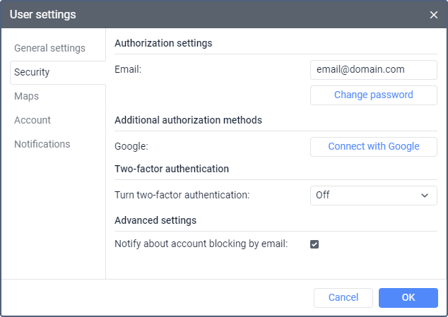

Advanced settings
Here you can configure notification sending in case of account blocking.
Notify about account blocking by email
Enable this option to receive notifications about account blocking to the email address specified in the user properties. Notifications start arriving daily 5 days prior to blocking.
To work with this option, you should activate the Еmail notifications service in the account properties.

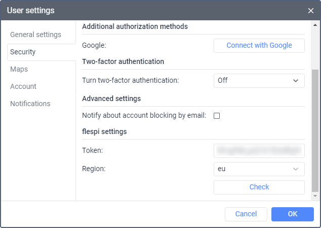

flespi settings
This section is designed for flespi users.
Authorization
To obtain a token, click on the Login button and authorize in flespi.
Token
The field with the generated token is displayed after successful authorization in flespi. The token is valid for one year. To see the information about the status (active/expired) and the expiration date of the token, click on the Check button. If necessary, you can edit the token manually.
Region
The data of flespi users is stored in a data centre in the Netherlands (the eu region).
