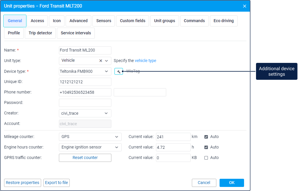

This tab contains the main unit properties. To save a unit in the system, it is enough to fill in the fields marked with an asterisk (*). But in order for the unit to connect to Wialon and be able to send messages, you should also fill in the Unique ID field.

The type of device installed on the unit. Start typing the name of the device model or find it in the drop-down list. The list is formed according to your license. If the required device is not listed, you can send a request for its integration.
The three device types you use most frequently are shown on the right. You can select them with a click.
If special settings are available for the selected type, the icon  is displayed.

Unique ID
The identification number of the device in the system. It can be the IMEI, serial number, or a custom value. In the hardware information on the online.stavtrack.kz website, you can find out what is used as a unique ID for your device type. The IMEI and serial number are usually indicated on the tracker. If the ID is customizable or you don't know it, use the unique ID verification service.
The maximum length is 100 characters.
Units shouldn't have the same Unique ID. If you create a unit with an ID which is already used for another unit, this value is not saved.
Phone number
The phone number of the SIM card installed in the device. It should be indicated in the international format (for example, +7 9XX XXX XXXX). If the device supports two SIM cards, you can specify the second number.
Units and drivers shouldn't have the same phone number. If you create a unit with a phone number which is already used for another unit or driver, this value is not saved.
Password
The password of access to the unit which is required in some device types to execute commands and receive data.
