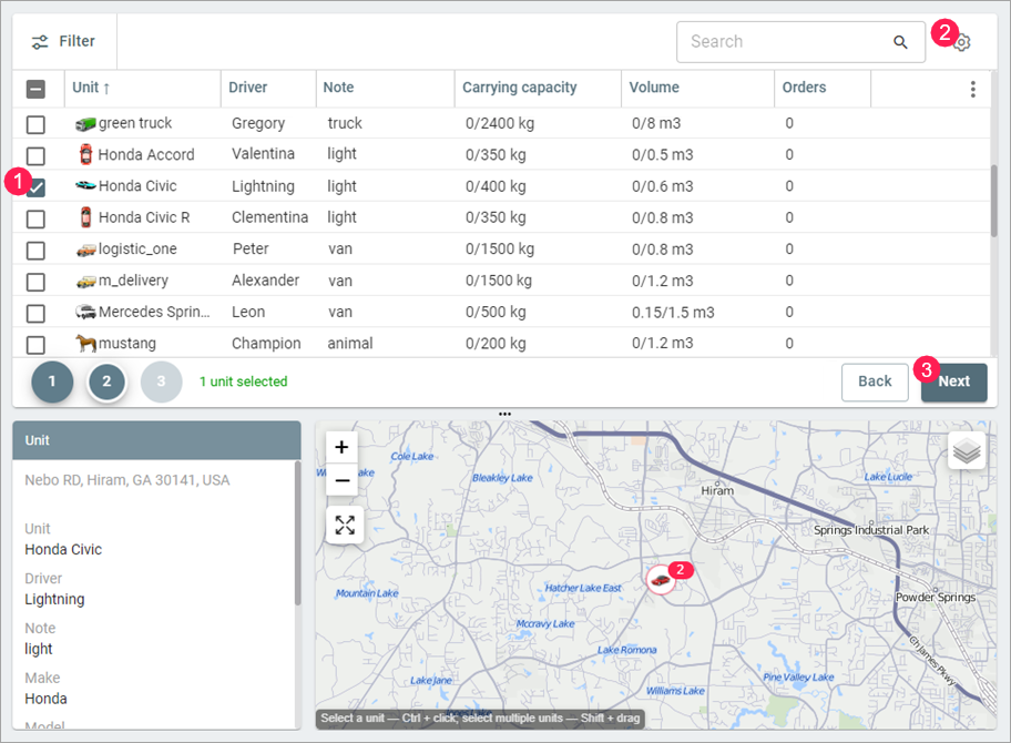

At this planning stage, it is necessary to determine among what units the selected orders should be distributed. To do this, follow the steps below.
  1. Select the unit or units that should be used to fulfil the orders.
  1. Change the planning settings if necessary. At this planning stage, the same settings are available as at the previous one.
  2. Click Next to proceed to the route creation.
In the table, you cannot select the units without location data if the Take into account the location of units option is enabled in the settings.
The interface components available at this stage are described in detail below.
Table
The table displays all the available units.
The table consists of the following columns:
ColumnDescription
Make (Brand), Model, Registration plate, Carrying capacity, Volume (Effective capacity), Dimensions
The values specified in the same-name fields on the Profile tab of the unit properties in Wialon.
You can also specify the values for the Carrying capacity and Volume  columns on the Units page.
Delivery requirementsThe values specified in the same-name field in the window for editing unit properties.
NoteThe value specified in the Comment field on the Profile tab of the unit properties in Wialon.
DriverThe name of the driver assigned to the unit.
OrdersThe number of orders already distributed to the unit.
Per 1 km, Per 1 hour, Per 1 order, Per vehicle departure  The cost values specified in the same-name fields in the window for editing unit properties.
Using the icon , you can change the number and sequence of columns in the table.

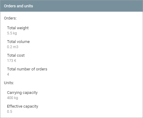

When you go to the second planning stage, the Orders and units block is displayed by default. It provides summary information: the total weight, volume, cost and number are shown for the orders; the carrying capacity and volume are shown for the units. The values of these parameters change depending on the number of units selected in the table.

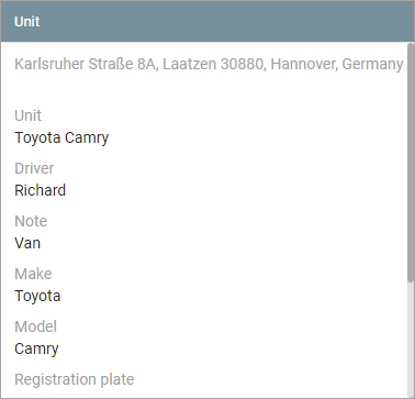

After clicking on a unit, the block displays its profile properties (name, note, make, model, registration plate, carrying capacity, volume) and the name of the assigned driver.

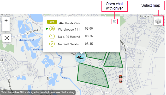

Before the unit selection, the delivery addresses and units are shown with markers on the map.
After clicking on a unit, you can see its name and an icon for going to the chat with the driver assigned to this unit. Besides, a coloured rectangle displays the number of fulfilled and planned orders for the unit.
If the driver is not assigned to the unit, you cannot go to the chat.
At all the stages, there is a button for the map selection in the upper-right corner of the map.
